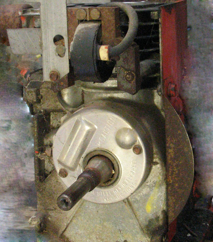

The magnet on the flywheel and the coil are visible when the recoil starter is removed. To change the points you don't need to remove the coil, but checking the gap at this time is recommended. For most Briggs, the gap should be .006".

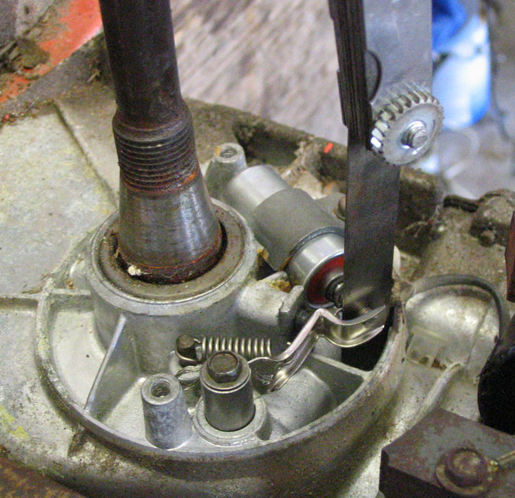

The points and the condenser are located under the flywheel. Points are to be gapped at .020". You can file the points and re use them, but the replacement parts are very inexpensive, so replacing them outright isn't prohibitive.

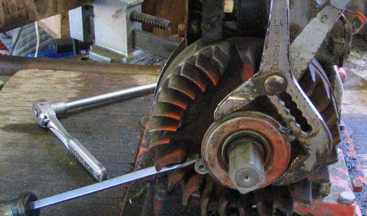

Using a special tool, or a pair of channel lock pliers, grasp the clutch and turn counter clockwise to remove the clutch. Use a stout screw driver between two of the thickest fins to keep the flywheel from moving.
The flywheel is cast iron, which is brittle. Be careful with it.

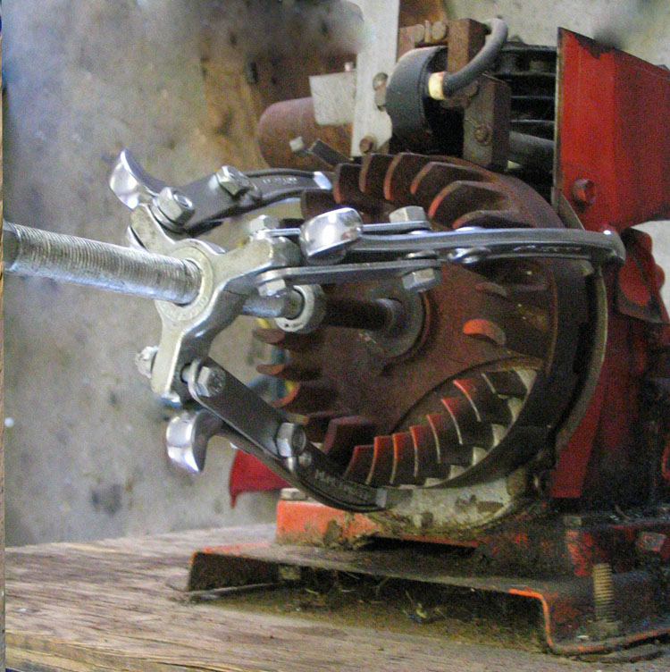

Special pullers are made to remove the flywheel, but we found that a large 2 or 3 jaw puller worked just fine. The puller will need just a partial turn to break the flywheel loose.

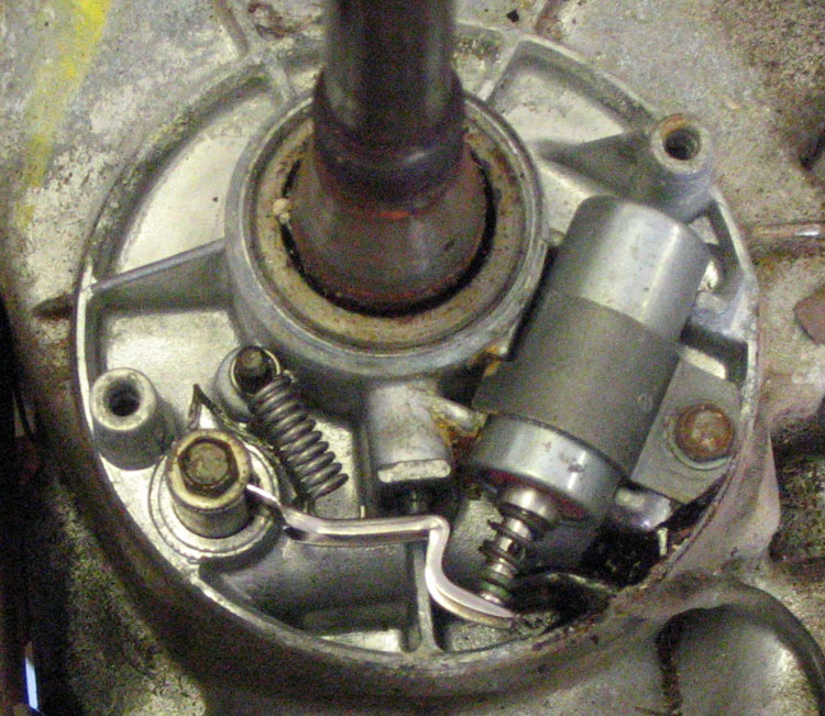

The Points
The cover for the points will now be visible. Remove the screws and inspect the overall system.
There should be no moisture or oil behind the cover. If there is, new seals will need to be installed. Contaminants behind the cover speed fouling of the points.
New points kits are available at most hardware stores, and at lawn mower dealers.
Remove and inspect the contact points for burning and strange wear, then discard the condenser and the rocking arm. Install the new ones, using caution not to strip the small bolts.
Gap the points at the recommended distance using a feeling gauge.

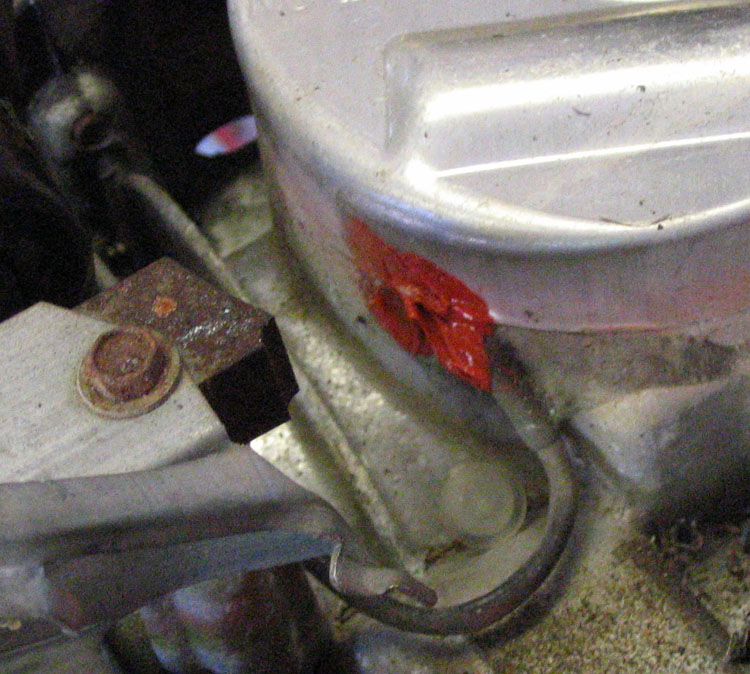

Finally, use RTV gasket material to seal the hole where the wires exit the cover.

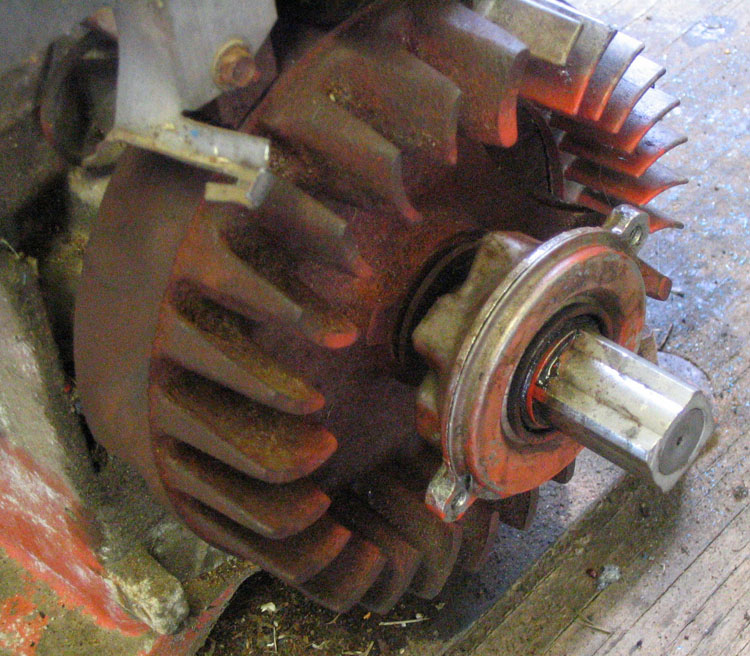

Reinstall the Flywheel
Put the wheel back on, and tap with a wooden mallet, 2x4, etc. Do this evenly across the entire surface so that the blow doesn't strike just one fin, or push it unevenly.
Check the coil gap again, reinstall the clutch and housing, and you're done!
