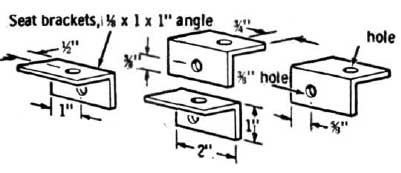

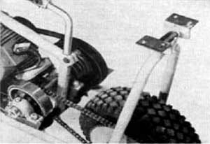

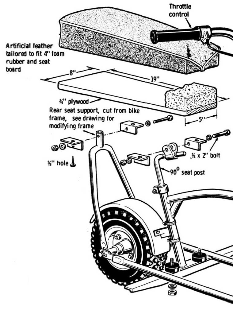

Seat and Mounting
You can make your own two-passenger seat as shown in fig. 1, or buy one from the parts houses. The seat will mount in the rear to a support made from the rear fork (fig. 3) that was cut off the bike frame, or fabricated yourself. A 90 degree seat post, a stock bicycle item, is needed to move the front seat mount farther forward. If this is unavailable, improvise.

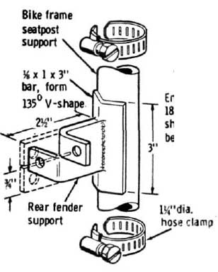

Fenders
You can find chromed fenders from parts suppliers, and you may mount them in an adjustable way shown in fig. 4 and fig. 1.

Throttle Control
Parts houses sell twist-grip throttles in both 7/8" and 1" sizing. This will fit most of the handlebars you may encounter. The throttle cable should be routed to the engine and installed according to the make and model of the engine. Zip ties are great to keep the throttle cable out of the way.
