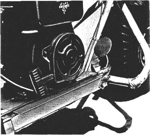

include "/srv/www/www.diygokarts.com/top-ads.html"; ?>Most commonly people use tiller engines for the power plant on these little machines. They should be horizontal mount. You'll need a centrifugal clutch if the motor you find isn't already equipped with one.
The scooter we've shown uses a four-cycle engine. You'll want an engine-to-wheel ratio of 25-30 to 1. This will depend on your clutch size, are they come in a variety of tooth sizes. We'll be publishing a gear ratio chart to help with this selection.
