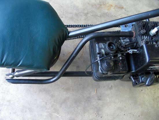

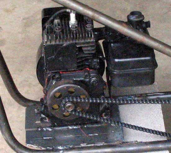

The Engine
We used a 3 hp Briggs and Stratton engine for the small mini chopper. This is a horizontal shaft engine, found on tillers, go karts, and the like.

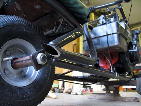

Open Pipes Custom Exhaust
Black pipe was purchased at the local Home Depot. After measurements were made, the 1/2" pipe was bent at roughly a 60* angle.
This bend was measured, and the next bend was selected. An opposite bend was made in the opposing direction finished our exhaust pipe, which fit the profile of the frame very well.
Installing the Custom Exhaust
The engine was removed to install the exhaust, since it had to be screwed into the block. The result was phenomenal. The open pipe completely changed the tone of the engine. Rather than the predictable "lawnmower" sound, a deeper, satisfying "blat, blat blat" emanates from the pipes.
