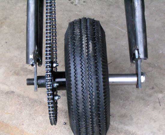

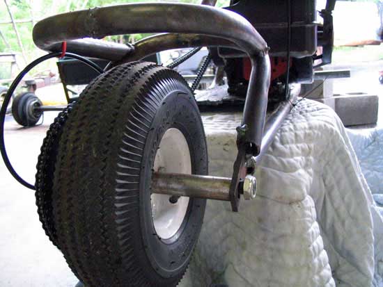

Then we made two 90* pieces of material for the rear wheel assembly. Since the pipe bender won't make a 180* bend, you must make two pieces and then weld them together in the "U" shape. This "U" should be longer than necessary so you can cut the material to length when you mock it up.

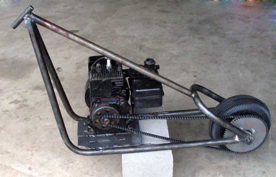

Engine mount was custom sized for the frame from a purchased engine mounting plate and 1/4" flat stock welded to form the correct size. When welding long welds like these, ensure that you tack first and use lots of short welds so you don't warp the plate or frame.
You can make your own mounting plate, but it's often cheaper to buy them, and you won't need cut the slots for the mounts.
Position The Engine
When designing your frame, consider where your engine will fit. You'll want the engine to be close to the rear wheel to minimize chain length and position the clutch farther from your legs.
Tack the plate in to your frame and place your engine on it, noting the adjustment travel, exhaust and carburetor clearances
