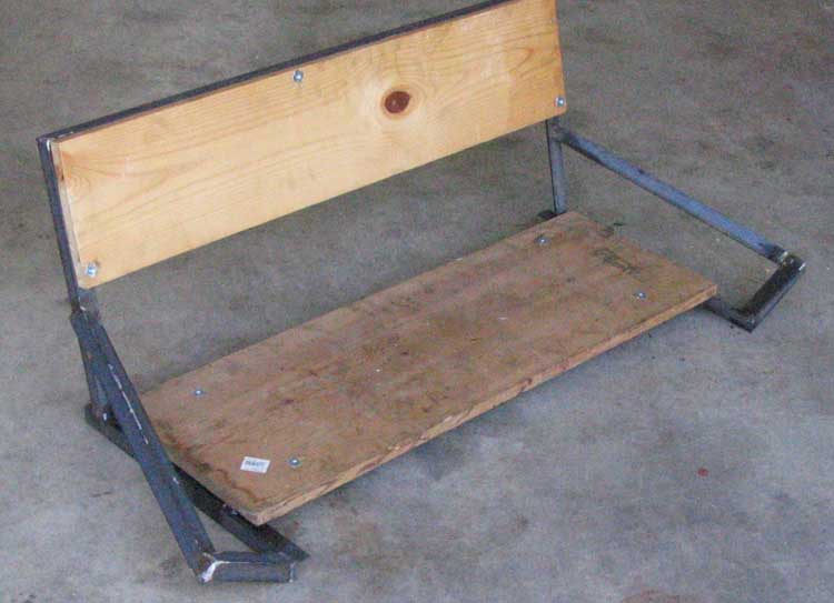

First you'll design you seat framing. Fig. 1 shows the basic completed frame. It's up to you to decide at what angle you'll want the backrest, and the width will obviously be dictated by the kart frame.

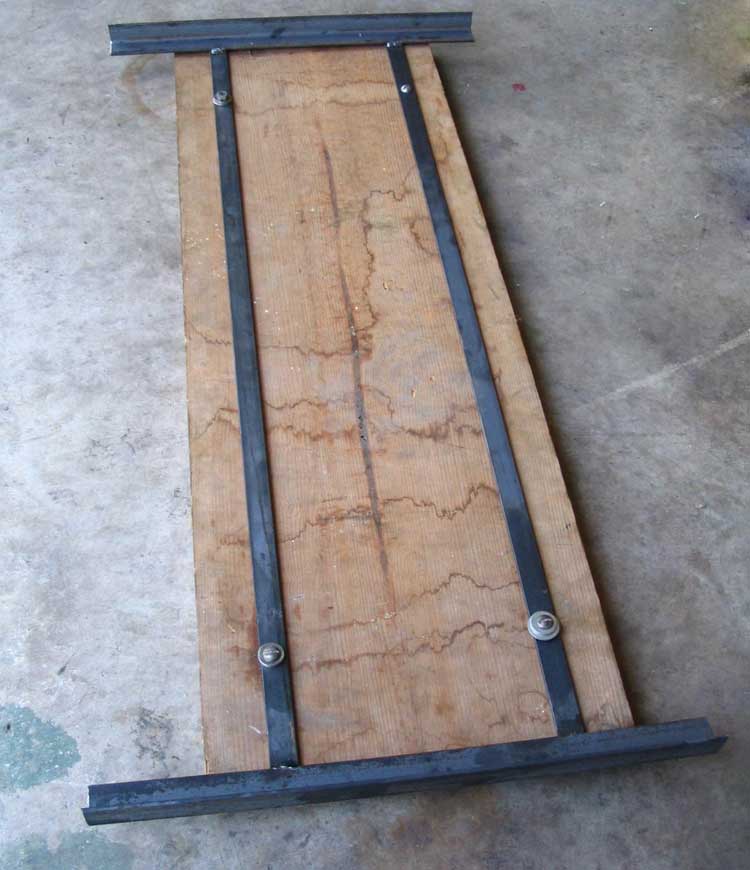

Fig. 2 shows the underside of the frame. The angle iron was measured to provide 1/8 spacing on either side of the frame. So for a 40" wide kart, our seat frame would be 40 1/4" from the inside to inside.
The two pieces of angle are connected with 3/4" x 1/8" flat stock, which is then bolted to the bottom of the seat pan.

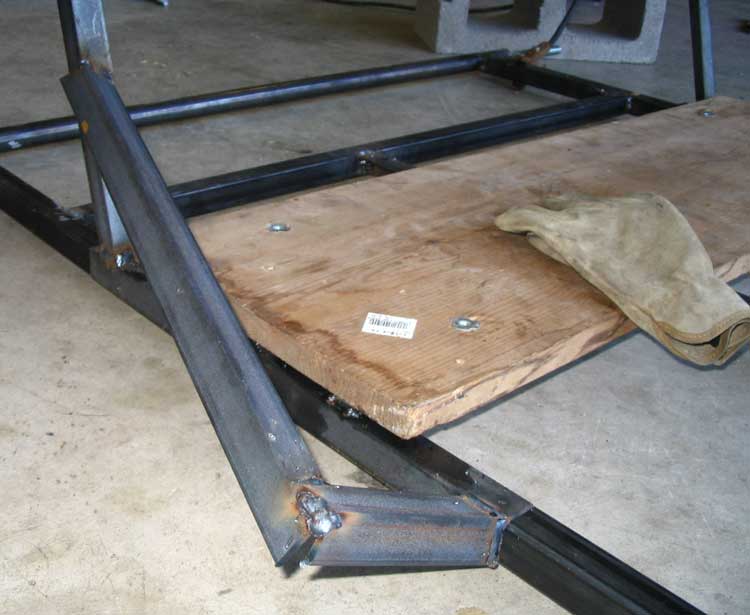

The seat angles back at 15 degrees. The side rails were made from angle, which was filled in and ground at the corner shown (Fig. 3).
After you're done making the basic frame, you can frame out the seat area. Plywood or boards make fine seat pans. Cut the wood to size, and round the edges with a sander for comfort.

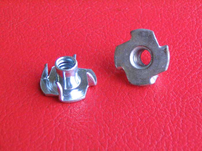

Special nuts make seat attaching easier. They are made to be pounded into wood, and then used with normal bolts. This allows you to attach the seat without cutting into the upholstery on the front side. See fig. 5.

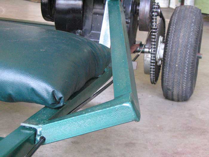

Fabric stores sell foam and vinyl for the upholstery, but you should wait until you're done welding on the frame before putting the finished seat in. Until then, install the boards in their positions so that you can sit in the kart as you continue building.
Finishing Up
When completed, the seat is installed on to the kart frame.
